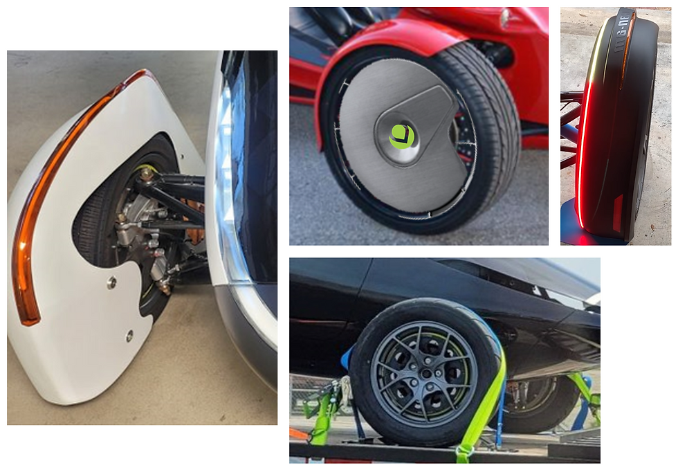

@Max Conrad@heistp Hi all, I still believe that if the huge wheel covers are replaced with simple ones like the one in this picture, the 2m/78.7in width will be achievable without compromising steering performance.
@loswa Thanks, that seems like a relatively easy way to do it, but I'd like to see how that impacts Cd. The wheels are already a significant source of drag, from the simulations I've seen.

@Max Conrad @heistp Hi all, I still believe that if the huge wheel covers are replaced with simple ones like the one in this picture, the 2m/78.7in width will be achievable without compromising steering performance.
