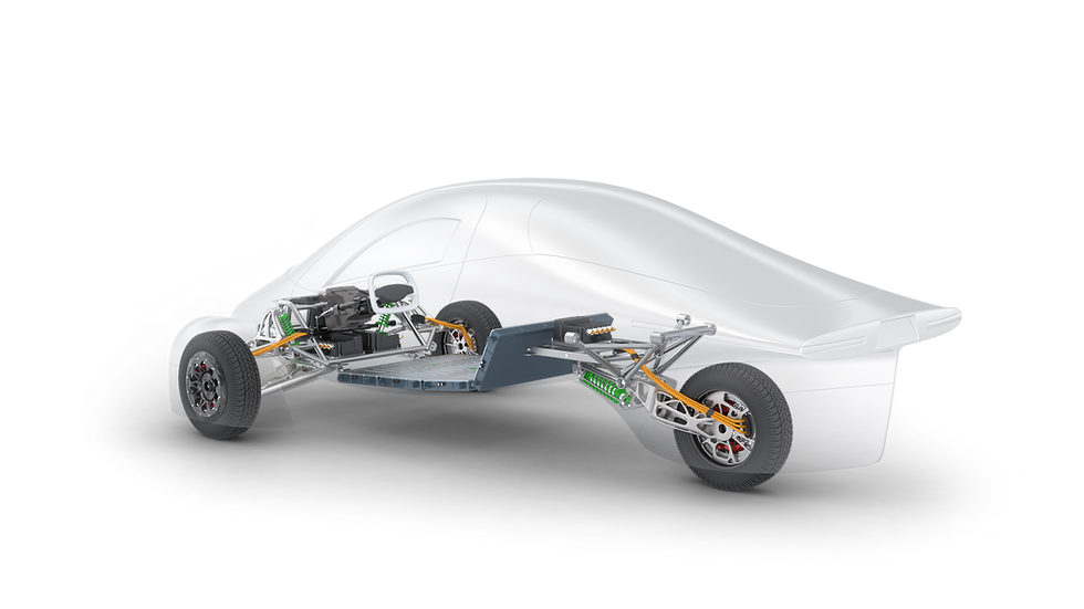

How is the heat gathered? Are they running fluidic channels all the way up there? It seems like using the belly pan as the main heat exchanger between the inside and the outside of the car makes a lot of sense since it sounds like it can be replaced in the event of damage in an accident. It has always sounded as though they were embedding microfluidic channels in the composite shell, but that doesn't seem like a good idea to me for many reasons. My guess is if they need more cooling/heating than the belly pan, they are using the hood/roof panels to provide the surface area required.
The cooling will be on the under belly of the Aptera. The top is only for gathering heat for the batteries in winter.

I honestly don't know what their micro channels look like. They have talked about replacing the belly pan when something goes wrong, so it could be that the belly pan is made out of aluminum or composite, and could be thought of as a radiator without fins. There are a lot of options I can think of: graphene film, aluminum foil, pitch fiber - all of these would provide thermal conductivity just under the skin, in plane with the skin. The microchannels are probably a compliant mat of very thin plastic, glued or ultrasonically welded to create the channels.
I think most of the heat is being dissipated through the belly of the Aptera, and less on the top and sides. The poor thermal conductivity of the composite and foam materials should keep the bottom much cooler than the top and sides. With that said, it is a legitimate concern for a black car, but one they should be able to explore with the prototype. All this movable parts, flaps, radiators, etc. talk will add weight, complexity, cost and lower reliability. It violates the KISS principle.
