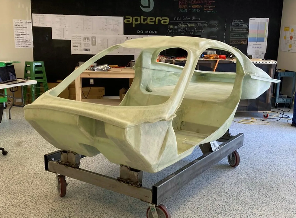

I found a new (to me) photo of the tub. It appears to have a major bulkhead behind the seats that would narrow the storage in that area.

I wonder if the bigger batteries (100 and 60 kWh) will rob some of the flat rear storage area?
So, after all my guesstimating, I think the golf bags will fit, but they need to be separated from the pull / push carts!
It will be interesting to see if I'm close or not when "real" data is available.
