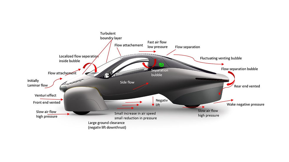

Since the Aptera looks like an airplane fuselage then at highway speed the rear wheel should rise off the ground through ground effect and settle back down for traction when needed. Truly a scientific wonder vehicle for the ages then.

Actually, what little drag there is has been designed as down force at the back of the car. 25 lbs at 65 mph and rapidly increasing with speed.
