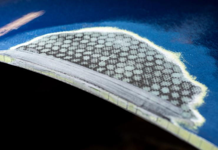

Hi, I was thinking about repair of the car in case of a fender bender. The monocoque is stated to be a honeycomb core based composite structure. While this lends itself to a rigid light weight structure, it will likely delaminate (disbond of the skin from core) or puncture if impacted. If someone backs into it or it is hit by something bouncing down the road there could be issues. Very few automotive focused shops have any kind of composite repair capabilities. One might get away with drilling out a damaged area and pumping the core full of resin. Minor repairs might be made with local vacuum banging and heat blankets, but good structural repair would require an autoclave and appropriate mold tools. Going into the autoclave would also mean stripping the monocoque down.
So, if a person got into a significant enough accident I wonder if the electrical and mechanicals could be moved to another shell? I recognize that the Aptera is fairly affordable, so it might be a write off if you get hit. Composites just behave differently than metallics when they are damaged. Fracturing rather than yielding and that kind of stuff.
I’m also curious if the manual system will have good non destructive testing instructions in it. Obvious delam can be found by a simple coin tap test, but I would expect some standards and inspection intervals for key load paths.
A bit of nerdy background, I ran the composite engineers for a major airline and aircraft maintenance repair organization (MRO) for about 10 years. We had large composite structures used in engine cowls, various fairings and flight controls forever. When we got 777s with their composite floor beams things got a bit more serious and with the A350 (composite fuselage and wings) and A220s (composite wings) joining the fleet things got really serious. Repair and inspection of highly loaded composites is a tricky thing. I love the idea of a composite car, but like EV charging, there is a whole infrastructure that needs to be developed to work on them.

Nice discussion. For those of you who are not aware, both the BMW i8 and i3 have composite life cabins of carbon fiber reinforced plastic. Except for fasteners and some electrical components the entire cars are made of aluminum subframe forgings and "plastic". When a structural composite area is wrecked, that section is cut out and a replacement section bonded back in. The plastic body skins are then attached. There are not too many shops who are knowledgeable on these repairs.

You have to remember that the construction techniques come from the boat building industry, not aircraft. Autoclaves are not used.
I work in the marine industry and know something about this. Most of your comments just do not apply to the vacuum bag and UV curing methods of construction. Many collisions that would result in crumpled metal with conventional metal parts will be a simple scuff repair on the Aptera. Materials for more extensive repairs are available at any West Marine.
Yes, I’m not saying that bonded structures aren’t the way to go, it’s just there is a whole set of different ideas that need to be explored in the long term to ensure that they are viable. Metal constructed cars have 120 years + of learning behind them. Carbon bonded structures in aviation have about 60 years, but they have rarely been out of environments where specialized tools, processes and trained people were near by. It will be interesting to see what happens when when this tech is in the hands of the masses.
